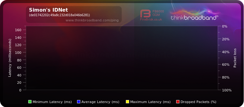

My Broadband Ping
DLM meanwhile has crippled the throughput. Trouble is that DLM keeps reducing my speed because, presumably, of all the disruption. I've lost over 30% so far in the last two weeks. My attainable speed is 42Mbps, the maximum allowed by the DLM at the DSLAM is 27Mbps. I have to pay £100+ to get it back where it was, apparently. What am I paying IDNet's rates for, actually? :slap:
#23
That is really weird. I'll try rebooting my modem and see what happens to my BQM.
Update- Yes, that seems to have sorted out the latency problem, but I have no idea what caused it in the first place.
