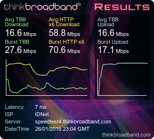

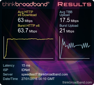

My speeds are all over the place again tonight. I normally get a steady 65Mb/s +, but this is useless

Interesting, speedtest.net to a server about 15 miles away shows

Has anyone else been seeing this during the late afternoon and evening up to midnight? started for me on the 25th Feb and seems to occur every day at around the same time.
Ray
I'm not seeing anything like that on my graph Ray.
Nothing unusual here either.
