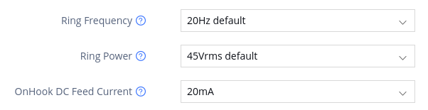

Quote from: Simon on Jan 14, 2026, 10:09:20I didn't think it could.  Does the router port provide power, like a PSTN socket does?
It should. A few tens of milliamps.
On a Grandstream the config looks like this:
and the bottom one can be set to either 20mA or 30mA.

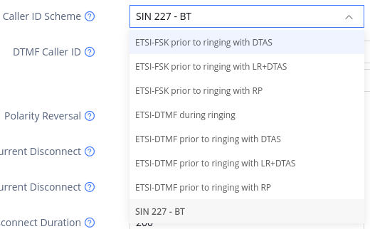

Quote from: Simon on Jan 14, 2026, 18:39:58I just tried it.  To my surprise, the call blocker was powered by the router, but clearly the system doesn't like it as it's not letting me receive calls.  It either blocks them, or the phone doesn't ring then the call goes straight to voicemail.  So I think it's probably best left alone.
You might need to make sure that the router is sending out the right format of callerid. Many phones will cope with different variants, especially the US type "bellcore".
You'll want one that's labelled BT or UK. Again, on a Grandstream ATA, the options look like this:
nowster
Of course, if your box doesn't like seeing Caller ID numbers starting +44, it probably won't work.
(A&A get this right. You can select either +44 or 0 as incoming number prefix. It wouldn't affect me, as I would be able to manipulate the caller ID inside Asterisk.)
